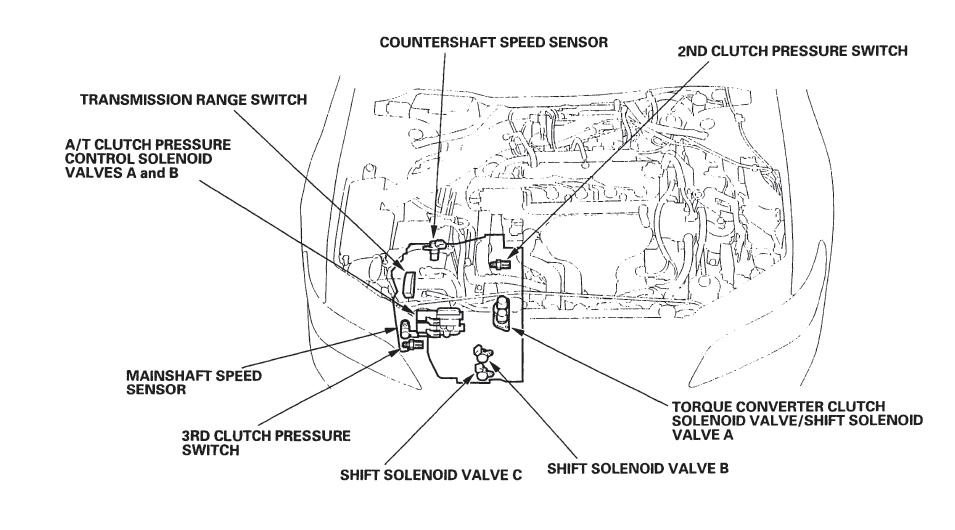

Update: I tested all of the solenoids per the FSM instructions and all of them tested good. My only question is this: the service information states that the resistance across either connector of the CPC solenoid A/B assembly should be "about 5 ohms." I got 6.0-6.2 ohms across each connector. When they mean "about 5 ohms," what would be considered excessive resistance? Could a 20% increase in resistance make a considerable difference in the performance of the solenoid assembly, enough to cause shifting issues?
Old Oct 1, 2016 | 08:12 AM
  #18
Which solenoids are you testing? Quick look, I see values differently.
If the tests are showing values outside of spec, you might want to grab a replacement - bone yard is prob the cheapest option - just be sure to test the replacement before leaving the yard.
Attached Thumbnails Transmission acting a little weird-6th-gen-trans-solenoids-4-cyl.jpg
I tested the TCC solenoid pair, the CPC solenoid pair, and shift solenoids A and B below the TCC solenoid. Someone reminded me that when testing for resistance, the resistance of the meter leads has to be accounted for, which is generally about 1 ohm. Makes sense to me. So in that case, I'm thinking the CPC solenoid pair is okay after all. Speed sensors seemed fine, but I might double check them. I also replaced the 3rd clutch switch a couple of days ago, but I haven't looked at the 2nd clutch switch as there was no code thrown indicating a problem with it or its circuit. I'll also double check the range sensor but I don't think that it could be causing these issues. Or could it?
