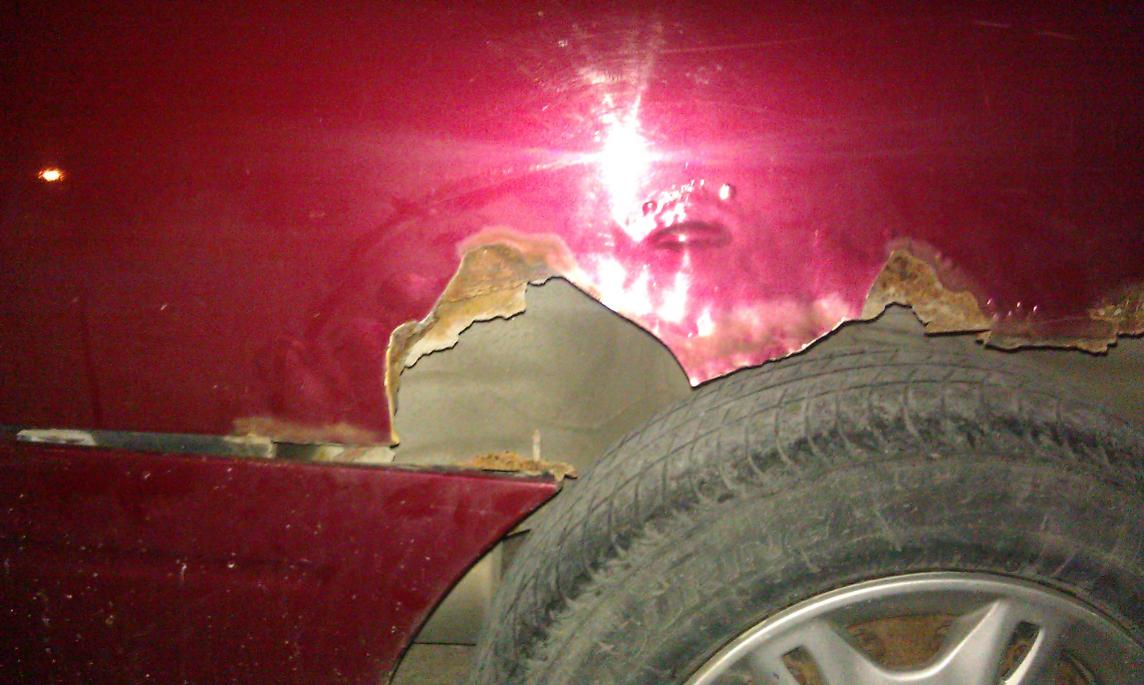

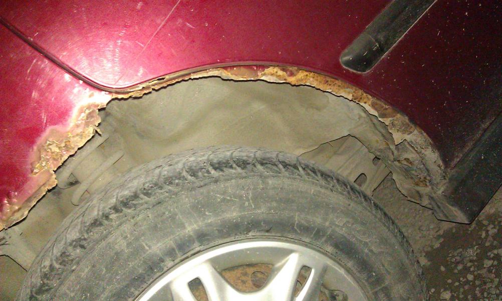

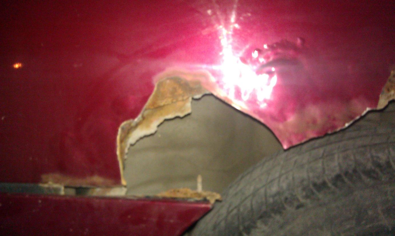

Second, The car has some Major Major rust, At first i looked at it and it looked like some fiberglass resin and alot of bondo would do the job, but after taking these pictures, there seems to be alot of metal torn off... Any hints on what i should to would be great, I want a half decent look but i dont want to spend 1000$ on fixing this wheel well. Any good tips would be great.

That rust on the wheel wells is common on those accords. Mine had bad rusting there too. There is a site called rixmyrust.com that sells panels that can replace the rusted part. The original metal will have to be cut accordingly, then the new panels welded in. Then you would have to primer then replace.
That rear panel is one big piece, so you would have a lot of work to replace the entire panel. I had found panels at a junkyard that were in perfect shape. I just don't know how to weld and decided not to worry about it.
