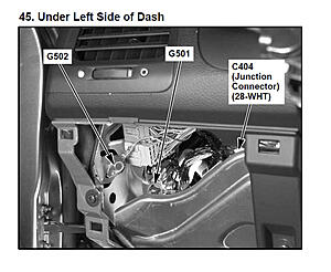

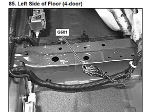

Have you checked your grounds (g601 and g502). Did your fuse box come with the MICU? If so was it a perfect match to the old one?

I read your first post wrong I thought you changed your fuse box but you stated you changed a fuse (I'm thinking you mean relay but just saying fuse). Am I correct on that assumption. So you have the relay unit, ground and MIUC that effects the signals. If you've already replaced the relay unit I would check grounds then look at the MICU.

502 right behind the glove compartment
601 on the left side of the floor
