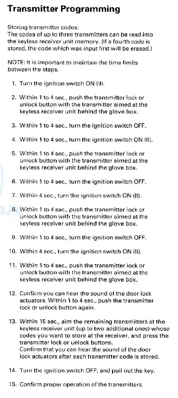

Old Jul 23, 2021 | 09:14 AM
Was this the procedure you used?
(1998-2002)
Old Jul 23, 2021 | 11:56 AM
gedalia's Avatar
Joined: Jul 2021
(1998-2002)
Thanks for your prompty reply Jim. No! I did not follow your procedure per se, but don't think it makes a difference. I say that b/c I've watched several youtube videos of ppl programing rheir Honda remote & none of them point the transmitter at the glove compartment but are still successful in programming the remote. Saying that, however, I jsut went out to my car and follwed your steps...pointing the transmitter at the glove compartment. No dice!

Old Jul 23, 2021 | 07:53 PM
I originally forgot to ask if it's a V-6 car. I only have the shop manual for the 4-cyl, but I THINK(?) the immobilizer and keyless entry stuff is the same.
The keyless receiver is built into the passenger-side multiplex unit, which (per the shop manual) looks like it's in the passenger's kick panel. That looks like it gets power from 3 different fuses:
- passenger-side fuse #13 (white/yellow wire)
- passenger-side fuse #6 (white wire)
- driver-side fuse #9 (yellow wire)
(wire colors just in case you want to open up the kick-panel & look for loose connections)
It seems like if that multiplexer isn't getting power, then a bunch of other things won't work, like windows, lights, & electric locks when you work the little physical button on the door. But maybe one of these power sources is just for the keyless receiver?
I don't think it's related to the keys programming; that is a separate system (the immobilizer) and unrelated to the keyless entry. Actually, you don't "program" the key. You program the CAR's immobilizer to accept the RFID serial# of the key. Just like the above procedure is supposed to program the car's multiplexer to accept the electronic serial# of the remote.
