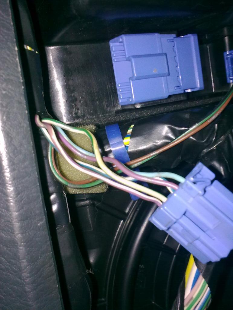

I just started to look for the OBD connector, but instead found this plug, (see attachment), disconnected, just under the glove box, above the passengers feet.
Does anyone know what this plug is for?
Thanks

It appears to fit the "holder" immediately above the plug.

Now I will say that I believe your ODB II connector is located behind your ashtray.
If everything is working correctly on your car then I would not connect it, just my opinion.

I did see the mating socket, I was just afraid to plug it in, in case someone had removed it for a good reason.
Didn't want to rock the boat.
I've ordered the Haynes manual, so once it arrives I should be able to figure out what it's for.

I wouldn't plug it in unless the holder doesn't have any wires leading to it or something is not working correctly on the car. IE, it's nothing but a holder. There are some like this to protect diagnostic plugs. I haven't seen one w/ that many wires, but may be there.
oops.
Sorry, I've been a plonker.
Just had a closer look and now realise the holder is just a holder.
I thought it had wires coming from it but I was wrong.
Maybe this is the diagnostic socket then?
Hopefully the manual has some more info.
Thanks

Turns out the 5 pin plug is the OBD connector.
