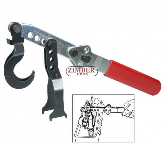

Ok, I know this is an oct. thread, but let me just say this for the 97 v6 valve seals --- NIGHTMARE.. total total total nightmare.. No where NEAR close to what they show in the videos.. Spring compressors? Forgetabout.... The ways the heads are design is pure insanity!
I had to use one of these and that barely worked... nightmare
