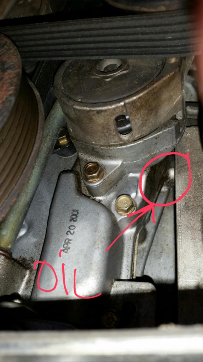

After further inspection I can't figure out where it's coming from,one pic is where oil pump mates to block by the idler,running down from cam seals?? Oil pump adhesive bad causing leak? The other pic is where oil is coming from,again I can't tell where it originates,oil pump?Cam seal?? I tried the dye with uv light and it helped but can't see where the leaks are from.ALSO,I found oil leaking from cam thrust covers on back of engine,also engine mount bolt (porous block?)..I wanna disassemble the front of engine to investigate but if it is the oil pump,how hard is that? I'm not sure if I should do that or send it to some9ne.What would you guys do???Thanks

I used the dye,I still can't see where it's coming from,looks to be from oil pump cover but it could be coming from above that and running down..I know the only way to know for sure is start disassembling, but to be honest,if it's the oil pump I'd rather pay someone to do it..UNLESS it's something I can handle??I'm pretty good mechanically,just never messed with hondas..
