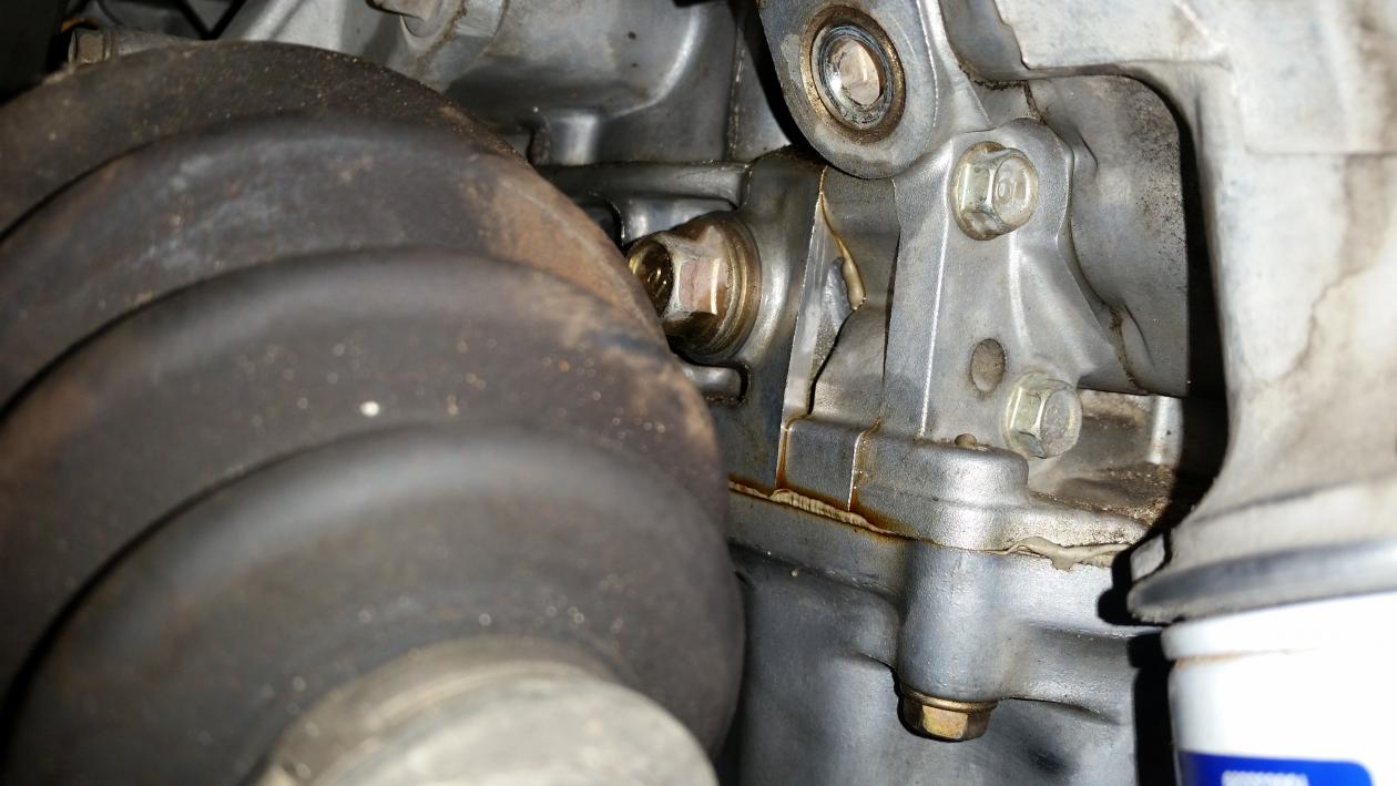

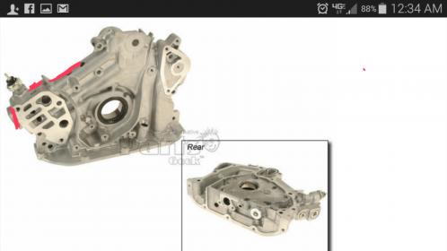

Here's a few pics,the bare block is just an example of where I'm seeing oil,the one by the filter housing is my engine and I can't figure out the source..How hard is it to reseal oil pump if I have too??Thanks again
Attached Thumbnails v6 oil leaks-20150214_141836.jpg   v6 oil leaks-2015-02-18-02.17.37.jpg   v6 oil leaks-2015-02-18-02.21.06.jpg

It is hard to tell from the pictures but it looks like you need to replace the crank shaft seal. Furth more the oil pump seal is not hard.

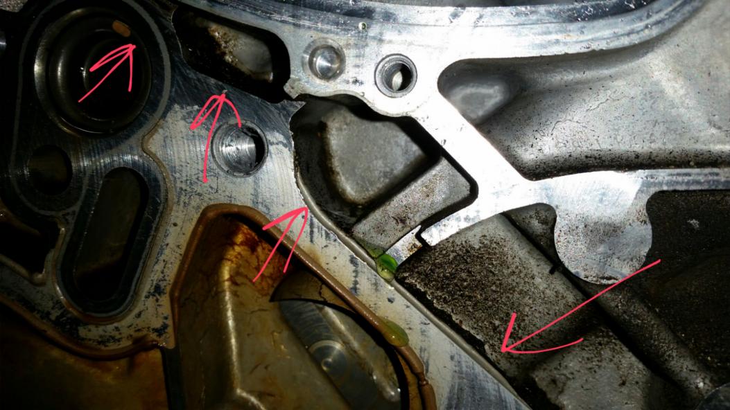

Well,I got the oil pump out and it really looks like the leak is from the rubber gasket in between pump an block..I pointed out these places in the pics.Also,while I have it apart I'm gonna go ahead a epoxy the pocket next to idler (spot of porousity in most blocks),then install the coated bolt in the other know possible spot..Hopefully that fixes it! First honda I've ever worked on,so far so good..
Attached Thumbnails v6 oil leaks-2015-02-18-17.56.00.jpg   v6 oil leaks-2015-02-18-17.58.51.jpg
