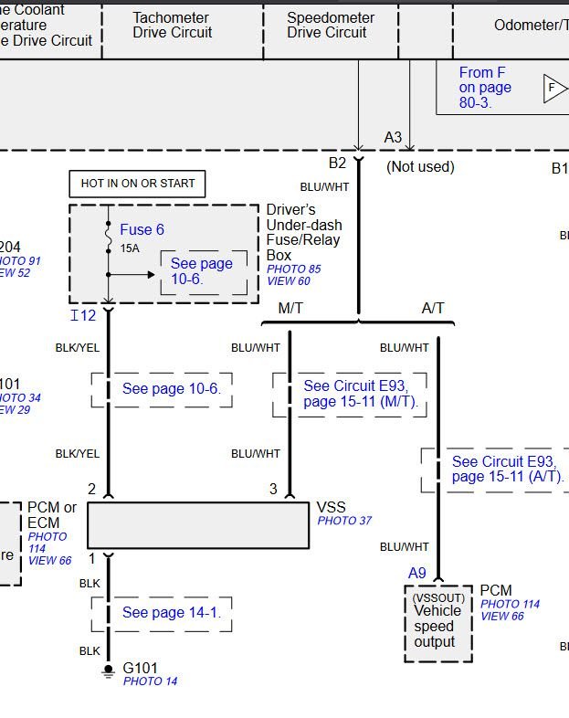

So I found the sensor it would seem I forgot to unplug it and pulled the 3 wires out. Can anyone confirm the correct order which they go into the connector. The black with orange strip I'm sure is in the right spot cause the whole metal inside came out. The other 2 the wires were just ripped. My cruise control is after market so I assume one is for that?. Any wiring diagrams?the blue and white one on the right in the pic fun into a hole in the fire wall

I got this from my Hanes manual so I think I got it right? It's just confusing me cause it has the black ground on the bottom

Old Dec 6, 2021 | 06:47 PM
Posts: 16,334
The wiring diagram is the electrical schematic and doesn't show where the pins are located. Some diagrams have numbers around the VSS box so you know what pin it is located.

Old Dec 6, 2021 | 09:05 PM
The wire colors for the terminals are:
1 - Blk
2 - Blk/Yel
3 - Blu/Wht
Since that is a female connector, the terminal numbering will be from the wire side of the connector.
