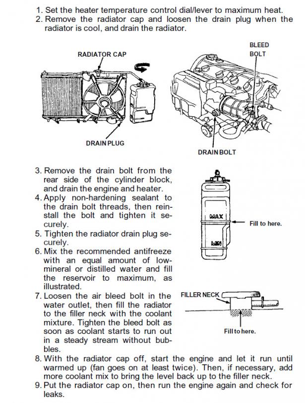

This is from the owner's manual.
Very helpful, thanks redbull!
