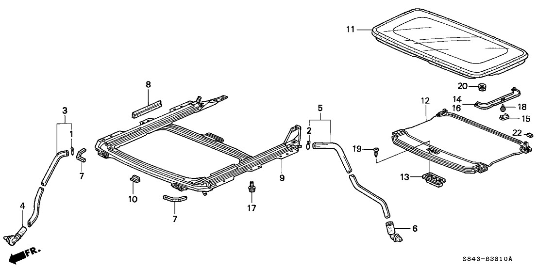

That might work if it's really the source of the leak, but you might also check the sunroof. There's a kind of raingutter running all the way around the sunroof. Each of the 4 corners has a rubber drain tube & it sounds like at least one of the drain tubes is clogged.
The front corner drain tubes go down the A-pillars & come out somewhere in the front wheel well. You might be able to poke something thru there, like a plastic line from a weed-trimmer. If you use a metal wire I think you risk putting a hole in the drain tube. Also be careful you don't poke hard enough to disconnect the drain tube at the top.

Thanks Jim. I'll suggest she take a shot at clearing the drain tubes.
