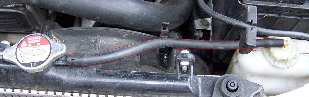

See attached pic. It appears to be the source of my coolant leak, but I can't seem to find it online. In case there is difficulty with the picture, it's a small hose that runs between the radiator (right under the cap) and the coolant reservoir. This is a 1997 Honda Accord EX V6.

Ummm, that would be your coolant reservoir hose.

You can see where it is leaking from where it attaches to the radiator. It should have a very small clip/clamp there. Yours is missing.

Overflow hose
