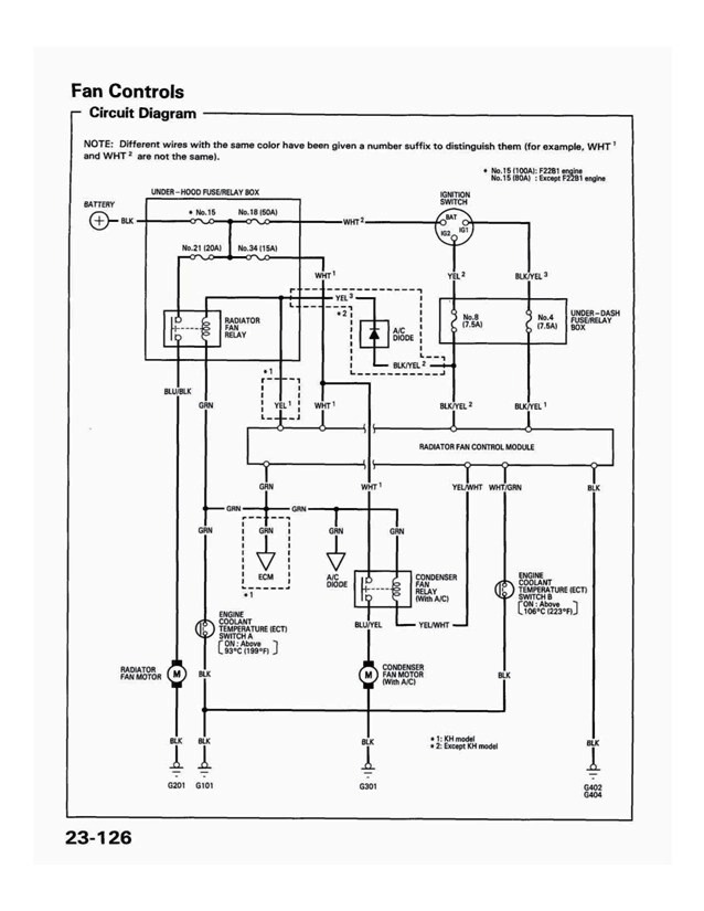

-Both fans come on when I switch on the AC
-The ECT on the water outlet which connects to the front radiator hose does not show continuity at 222 degrees.
-Both relays are okay
Attached Thumbnails What is the lifespan of a 94-97 Accord Radiator Fan?-fan.jpg

Overheating while moving forward at speeds at/above 20 mph could be stuck thermostat, low coolant level, or failed head gasket (gas entering coolant).
Very unlikely to be thermoswitch A which should turn cooling fans on at 94C. Your's may be out of spec, but still unlikely source of overheating.
Old Jan 29, 2014 | 01:57 PM
You say "radiator outlet housing ECT"... WHAT is that exactly? The radiator "outlet housing" is the lower tank, and there's no fan switch in there.
ECT switch "A" is located in the thermostat housing, roughly below the throttle body. This is the one you want, as that it the lower radiator hose (radiator outlet flowing towards thermostat).
ECT switch "B" is located in the nozzle where the upper radiator hose connects to the head. That hose flows towards the radiator, so I guess I'd call that the radiator inlet. That switch has no authority to switch anything until you switch OFF the engine. It controls the single radiator fan (not both fans) during the first 10 minutes after you switch off the engine.
Old Jan 29, 2014 | 02:01 PM
Now, if the car overheated during 50.F WHILE DRIVING, then I'd say it has nothing to do with the fans. By the time the car is driving 20-mph or more, that pushes more air than the fans anyways.
It's been my experience that in 50.F weather, it's difficult to get the fans to run while driving at any speed.

  • I did test the correct ECT, its just that I'm using the Honda shop manual terminology which reverses A & B.
  • I meant the ECT on the front of the engine .( I just didn't describe its position accurately.) There's no continuity between 170 to 240 degrees so I guess its dead.
