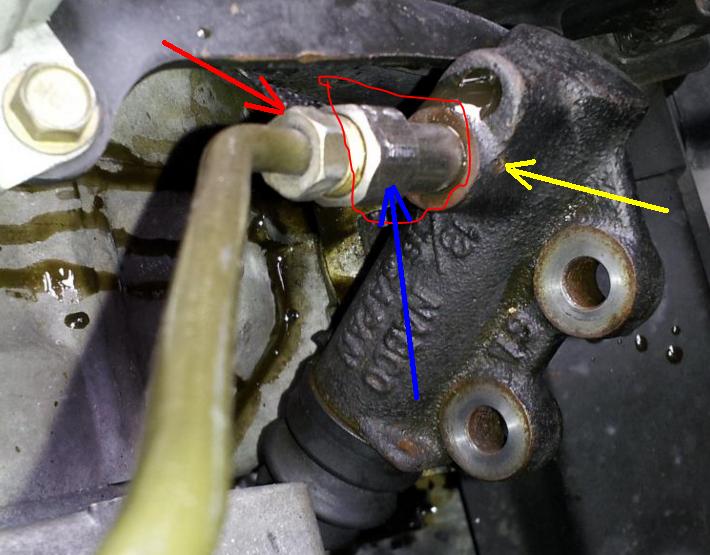

Hello,
While trying to replace the slave cylinder on my 2001 Accord EX 4 cyl, I broke the connector that connects the hose and the slave cylinder (see pic).
I can't find it anywhere. Any one know what this is called and if it can be ordered from somewhere? Thanks folks.

Not sure how you broke that?
There is a roll pin holding that fitting into the slave, it has to be driven out using a punch.
At this point I'd go a few different ways.
Bolt the slave back to the trans. Drive out the roll pin. Inspect the fitting to see if it is truly damaged or just needs a new o-ring at the bottom where it "seats" into the slave.
Or
Use two line wrenches and unscrew the line from the fitting. Then put the slave into a vise or something and then drive out the roll pin. Again from there inspect the fitting to see what is actually going on.
Old Mar 19, 2016 | 07:12 PM
I got bored.....and tried my hand a MS Paint.
Yellow is where the roll pin is at. To drive it out while still in there, again you will need to bolt the slave back to the trans or you will bend the line to it.
Or
use a line wrench on both the red and blue "arrow" hex fittings and unscrew the "red arrow" nut from the "blue arrow" fitting...it all of that makes sense
