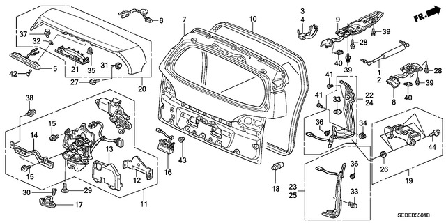

I think your part is listed as 23/25 in the attached picture. It is called a lower tailgate sensor assembly. It is not a heater. If your tailgate is powered, then this likely sends a signal to the motor to shut off.
Found the information at lingshondaparts.com
Attached Thumbnails What is this part called in english and where can I find it?-eu-accord.jpg

Yes that's it!
Ok I thought it was heating but it makes sense what you say
The one named 22/24 also needs replacing beacuse of a little rust.
Were on the site did you find this? Is there part numbers or names there?

Do you know why the part on the sketch has two numbers and there are only single numbers in the order list?
Old Oct 10, 2015 | 02:06 PM
Posts: 16,331
The diagram is misleading, because 23 is the right side piece and 25 is the right side. They are mirror images of each other and not identical.
