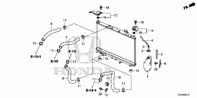

Please tell me what the part number is ( red marked) it,s a 2013 accord sedan
It is something that supports the radiator

Took me awhile to find it... Any on-line parts place, it's on the picture with the radiator hoses.
Radiator mounting brackets
Right upper (#14) 74171-T2A-A00
Left upper (#17) 74176-T2A-A00
Rubber bushings (#16) 74173-SJ4-00
