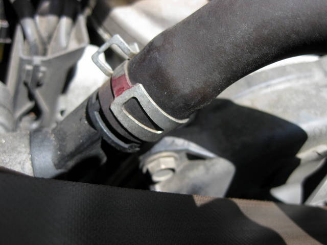

the belt

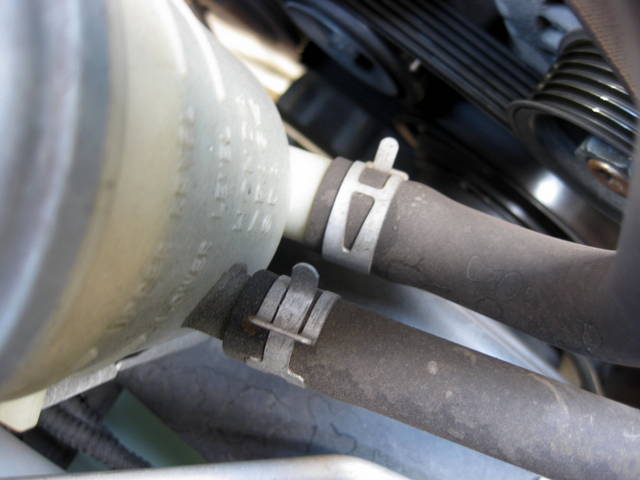

could these two hoses to the reservoir be leaking air?

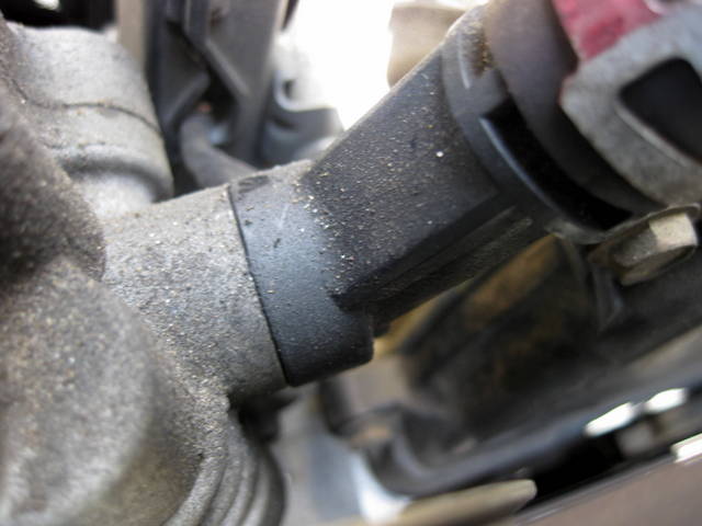

And there is a hose connecting from the reservoir to somewhere by a screw (middle of pic), maybe it is loose?
