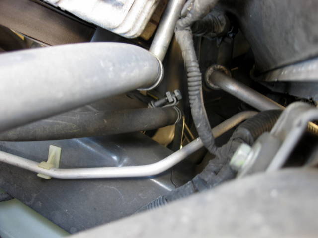

I see a lot of black stuff down there. I would check the connection on that hose, and the hose itself.

checked the hoses and connections, all in good shape and snug.
