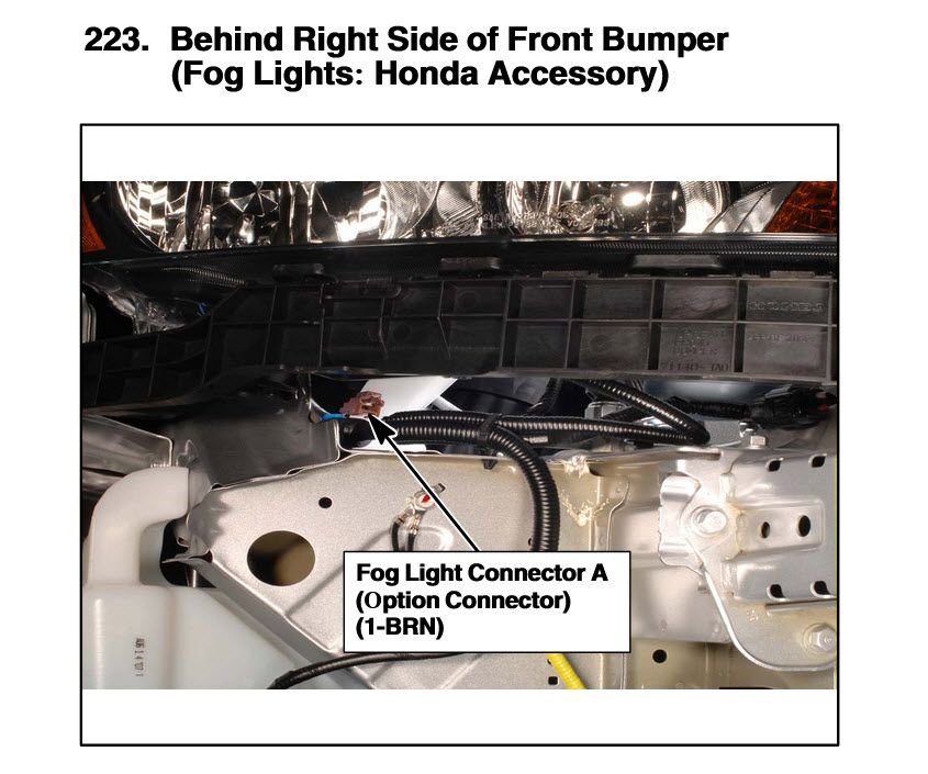

The Honda accessory fog light kit was only for 4 cylinder EX and EX-L trims. Your LX is not pre-wired with part the harness and connectors to connect to the fog light accessory kit. Also, adding a switch that has a setting for auto headlight won't make a car that is not equipped with it change into auto.
For example, the following are what an EX and EX-L has pre-wired:
