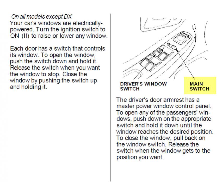

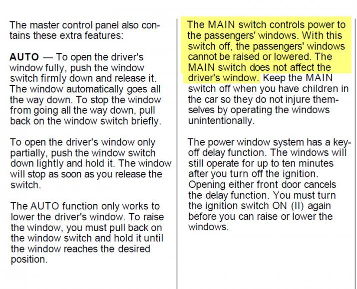

Old Jul 7, 2012 | 09:39 AM
First check that the Main Switch on the driver's door is not switched OFF.
If it is ON, it may be a problem with the Main Switch, which does commonly occur.
See attached pics. from owner's manual.
Attached Thumbnails window problem in 2001 accord-main-switch.jpg   window problem in 2001 accord-main-switch-controls.jpg

I thought I remembered all windows being disabled by Master Switch on some Accords. Is my memory wrong?

All I can say is WOW, do I feel stupid. I never use the child lockout switch so I didn't even think of it. Not sure if there are any models where it disables all of the windows but it took out the three on this car. Guess the old adage of "you have to be smarter than what you are working with" holds true.
Thank you very much for your help!

Of the three Accord manuals I have 90, 94, and 2003-2007, all only disable the pax windows and never the driver's window.
