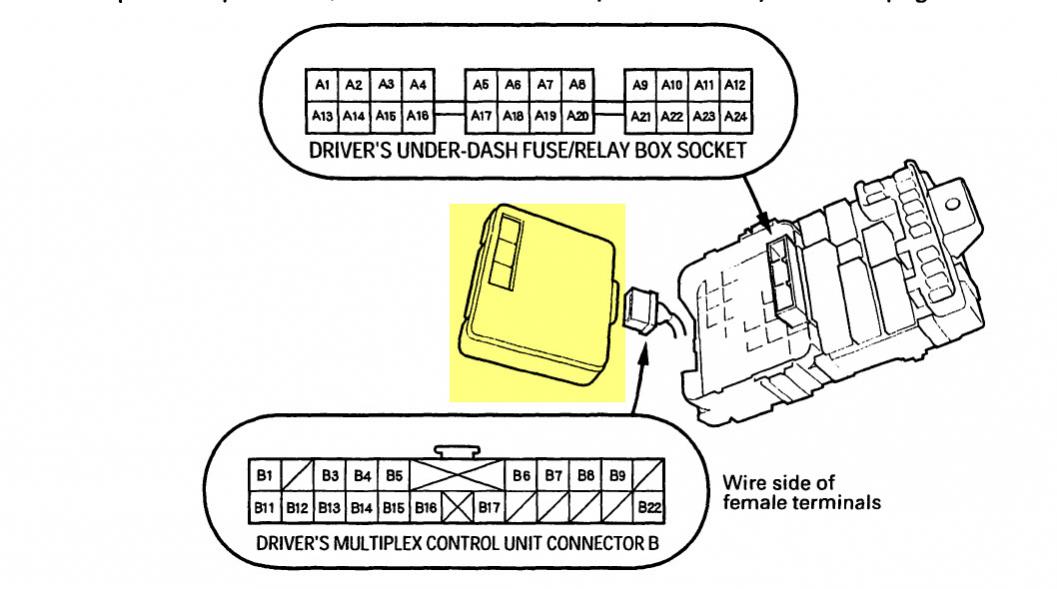

When the wipers run by themselves, is it running at the regular low speed, high speed, or intermittent?
The wiper issue may be caused by either the wiper switch or the driver's side multiplex control unit (located on the driver's side fuse/relay box).
Since you also had a power door lock issue along with the wiper issue, I suspect a problem with the driver's multiplex control unit. If the wiper speed runs by itself at intermittent, that may also point to the MCU.
Old Nov 6, 2014 | 03:57 PM
Although I normally don't recommend replacing a part without diagnosis, diagnosis of the multiplex control system is a little complex without the proper equipment. So, in this case, you may want to throw a part at the problem to see if it fixes the issue. The part list for $56.35 and is not very difficult to replace. There are essentially two connections (one on the fuse box itself and the other via a harness plug to the mcu).
Attached Thumbnails windshield wiper and power windows problem in Accord 01-drivers-mcu.jpg
