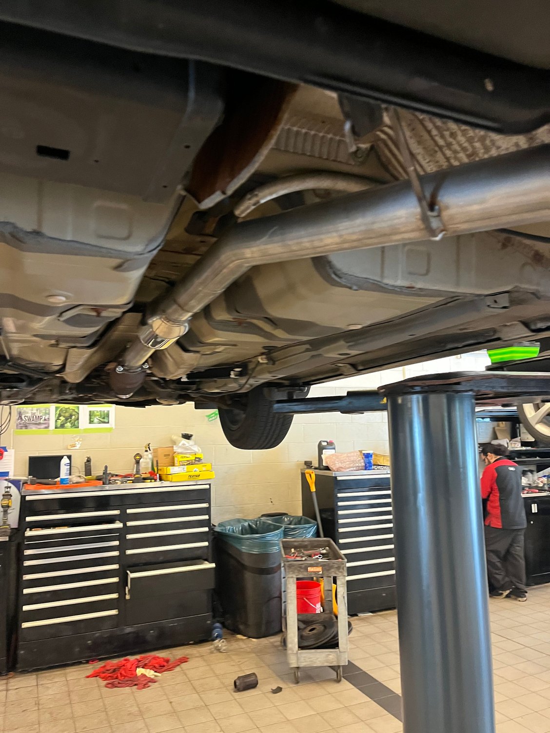

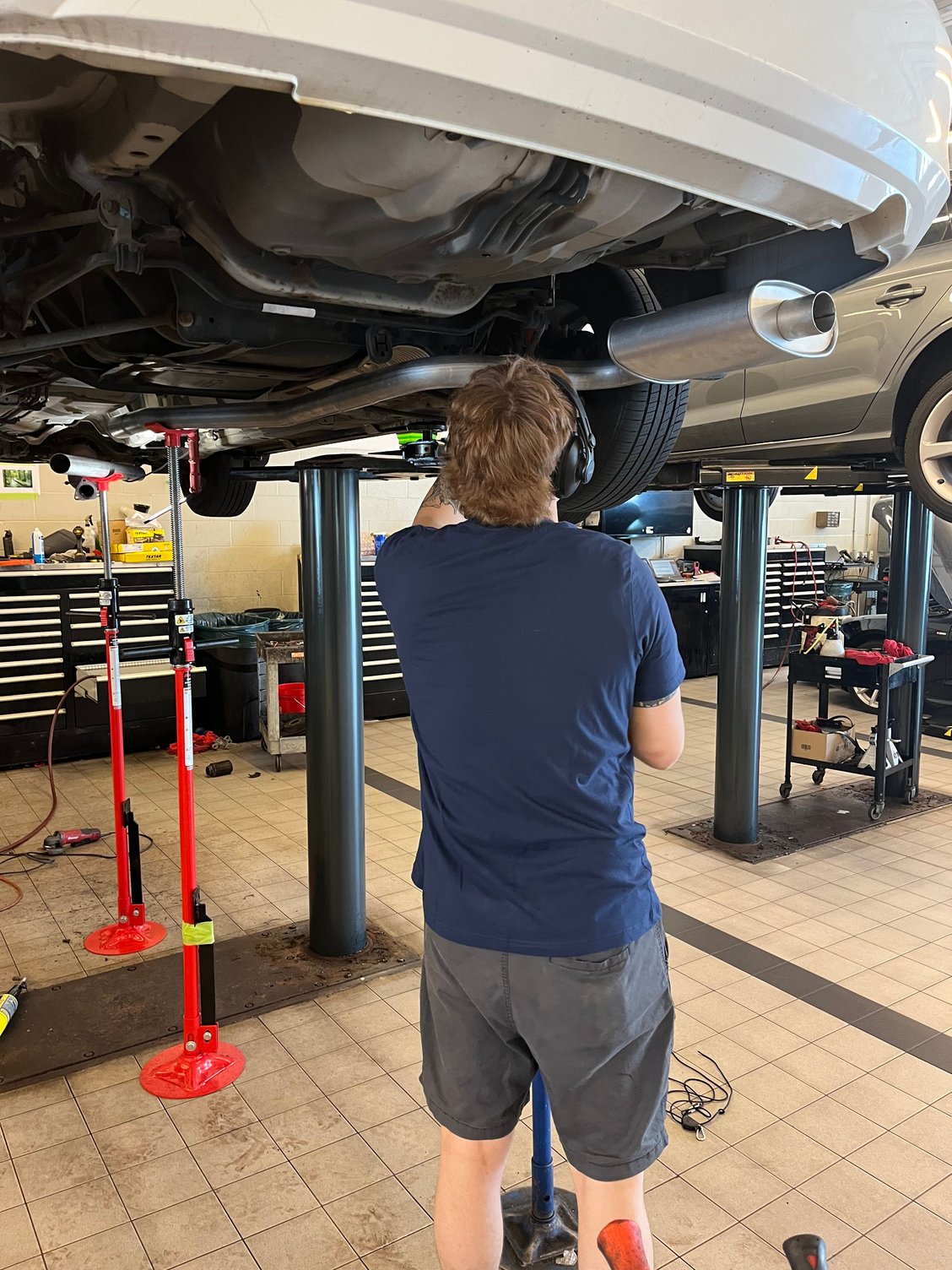

I just had my TruBendz custom system assembled and hung last week. I ordered the 2.5" aluminized single outlet kit for my `07 sedan 2.4ltr. I used Summit Racing's 12" SS resonator (part# SUM-630442) and turbo muffler (part# SUM-631125) along with a dual wall resonated tip from eBay. The technician had the system cut, welded and hung within 3hrs. I really like the sound...low resonant rumble @ idle with some attitude under load which is exactly what I wanted.
Getting ready to hang my custom TruBendz system.
The hung Summit Racing turbo muffler prior to installation of the SS tip.
Looking forward, the shiny Summit Racing 12" SS resonator in place.
Looking rearward, The custom TruBendz system before the rear axle.
