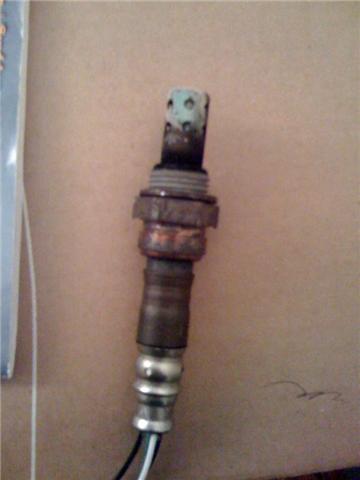

When I checked the old AF sensor (aka O2 sensor) I noticed a patch of green substance, presumably antifreeze (see pic). Does this indicate a blown gasket? I don't think I have a bent valve (I don't hear knocking or pinging). Looks like I had to replace the sensor in any case.
Is my best bet to take it to a mechanic at this point??
