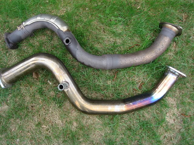

Sorry Brandon, but you are mistaken. The cheater doesn't get welded on. It screws onto the OEM bung and the O2 screws into it. It's just a small piece of pipe. The Megan pipe I have came with the cheater installed. This is a comparison pic of my stock S-pipe to the new one (you guys don't have this pipe).
