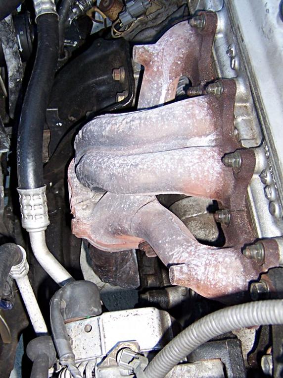

Hello!
I have a hairline but significant crack in my F22B1's exhaust manifold. Pics attached. I would appreciate thoughts and comments on what I have determined are my options for dealing with this.

Attached Thumbnails Cracked exhaust manifold: options?-01.jpg   Cracked exhaust manifold: options?-02.jpg

I just looked at your pictures, that is a pretty bad crack and you should fix it ASAP.
