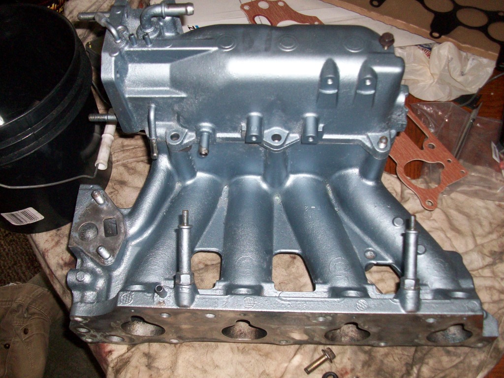

Heres an after. all clean

Did you media blast that thing, holy crap what I nice "After".

Thanks but I should mention that that pic up there wasnt a before- that pic I found. I thought I took a pic but I didnt, its been so long since I posted it. But thats exactly what it looked like actually. Pulled it out of a Upullit.
I bought a wire brush attachment for my drill and then sprayed it with VHT ceramic high heat.
I cleaned the inside real good with throttle body cleaner and soap. The inside was completely black before. I'm surprised with the results. Can't wait to get it in my car. I painted my valve cover with the same color too.
