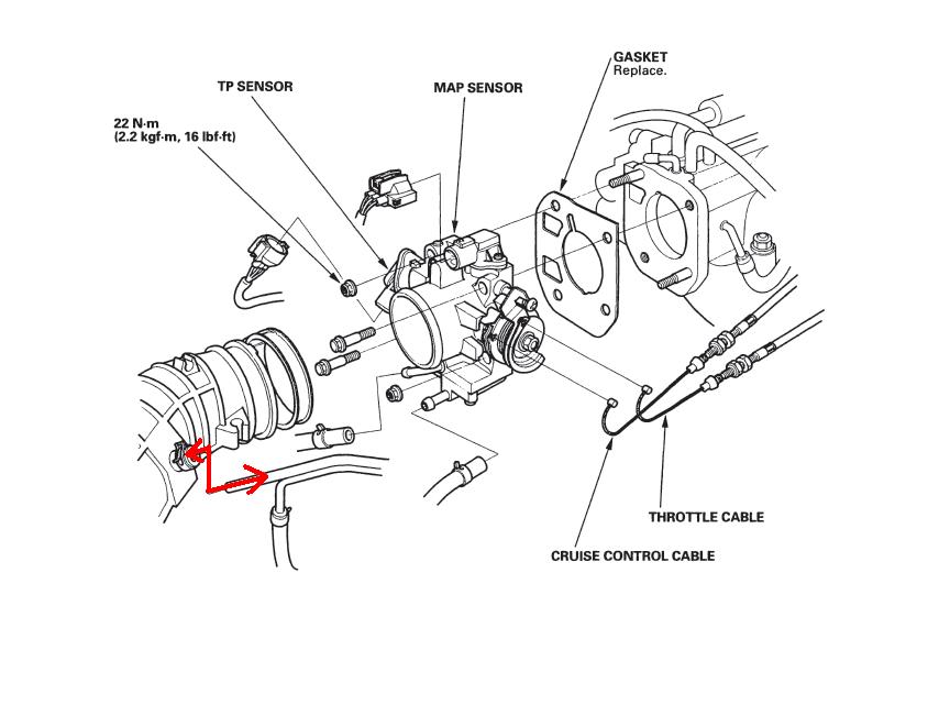

There is/was at least one hose connected to the OE intake. Forget exactly where it runs, but be sure it is either capped off or connected to the new intake.

EDIT: Found a Pic of the tube that connects to the oe intake tube....couldn't find the "other end" and what it goes to but with this you might be able to tell us.

I did re-connect the tube, and the intake came with some rubbing tubing that I used to attach it. As far as I can tell, there's no air coming out of there. The other end goes right into the engine.

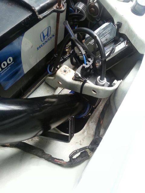

I think it may be from the intake not being properly mounted. The metal part typically used for mounting on my intake is in the completely opposite direction, so it can't be mounted to the support bar near the battery. Still trying to think of an easy way to mount it.

Just to make sure each end was sealed, I went out and bought two of these breather filters to clamp on. I also remove the intake from the throttle body and replaced the hose clamps that came with it with better ones because they were slightly loose. Drove it around for a few miles and the squeaking has been mostly alleviated. Those little filters look... special, but at least they helped.
Edit: I'm hoping the little bit of squeaking that's left is because it's only mounted with HID ballasts and zip ties haha.
