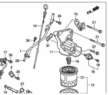

I'm going to go with this is a 97 (title say another, yet engine suggests/supports the text).
With that said.....the oil pressure switch is where I would start inspection, #16 in the pic.
Next would be the o-ring seal - #31 in pic

Another poster just last day or so had a severe leak from the oil filter base where it fits to oil pump cover. An oring was baked hard and leaking. This base is the fitting that filter screws down onto.
