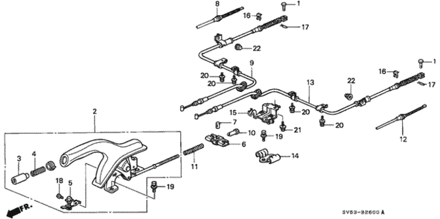

Your e-brake lamp is triggered by either the handbrake lever or the brake fluid level (go figure...)
Handbrake lever has a little switch (#5 in the picture). Check whether that's bent or something preventing the lever from pushing down the button on the switch. Then check for wires pinched somewhere in that area. The switch simply shorts a wire to ground, so if insulation is rubbed off the wire that's just like having your brake lever lifted up.
Then the cap of the brake fluid reservoir has a float switch for low fluid level. Wires messed up? Float might be wedged or stuck so it doesn't float? Or maybe your fluid level is actually low?

Thanks for your help Jim. From the repair manual I gathered I'd start at the brake fluid reservoir before I move on to the switch, but from your expert advice it sounds like I should reverse that course.

I didn't mean it had to be in THAT order...
Brake fluid reservoir is an easy visual inspection that the fluid is indeed full. Unplug a wire at the fluid reservoir cap & see if the lamp stays off. That's not a fix, but if the lamp stays lit then you can move to the handbrake lever.
