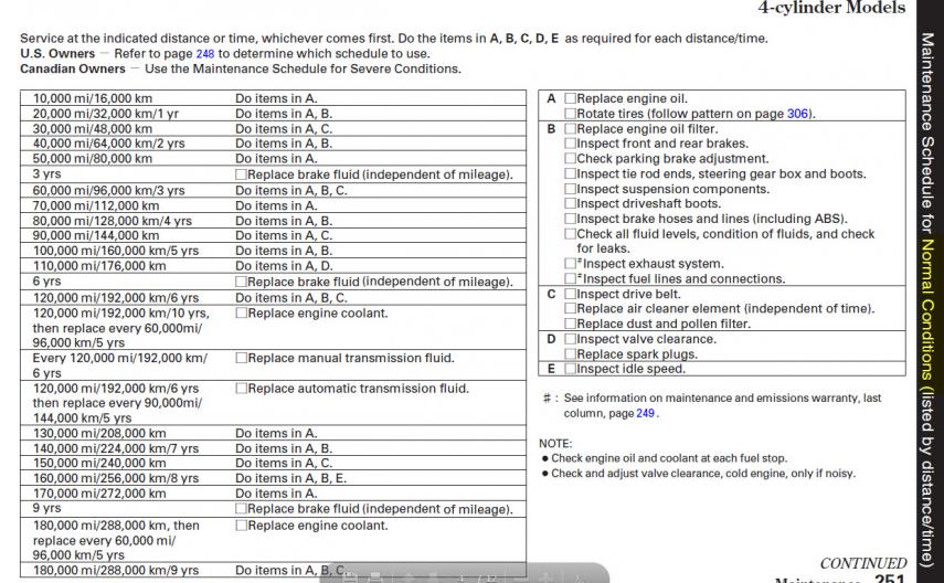

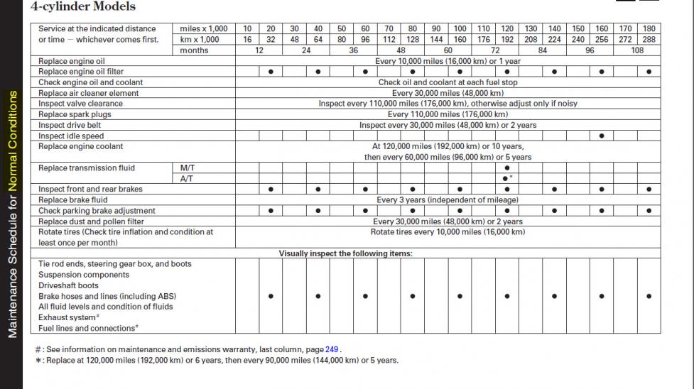

The maintenance schedule is part of the owner's manual. I've attached the normal schedule for a 4 cylinder. (Is your EX the 4 or 6 cylinder?)
If the car is a 4 cylinder, it has the timing chain and under normal conditions, does not require replacement.
6 cylinder has the timing belt, which requires change at recommended intervals.
Both 4 and 6 cylinders have a drive belt (aka serpentine belt).
If you don't know what previous maintenance was done, you might want to do some for piece of mind. But, you can do some visual inspections like check the air filter, the pollen filter (behind glove compartment), if it is an automatic (what color is the fluid), how does the brake fluid look, etc.
Check the condition of the drive belt. Look for obvious damage to the belt. A few cracks on the rib side of the belt is okay; but, a lot and it probably should be replaced. The auto-tensioner for the belt has a gauge, check the position of the gauge with the lines. Then start the car, does the pointer move around when the car is on; if it moves around, the auto-tensioner may need to be replaced and the belt.
If you have an automatic transmission, I would recommend doing a drain and fill. Use genuine Honda ATF. DW-1 is Honda newest ATF fluid and is synthetic.
Attached Thumbnails Just bought an '04 Accord EX-4-cylinder-normal-maintenance-schedule.jpg   Just bought an '04 Accord EX-4-cylinder-normal-maintenance-schedule-contd.jpg
