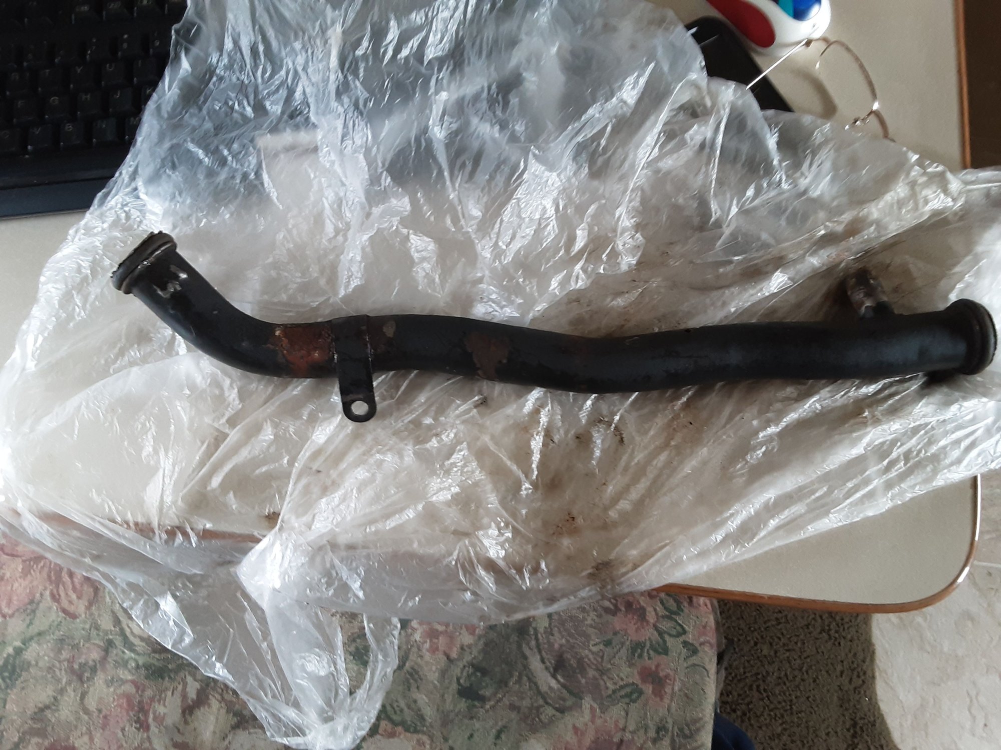

I have a 91 Accord F22A engine. I'm pressed for time to get my car running and have this one part stalling me
. I traced a water leak to the part shown in the following pictures. I cannot as of yet find a replacement part and have been having somedifficulties identifying the part by number or by correct name. Can anyone tell me what part this is or supply a part number. This part apparently is related to the heater hose and goes underneath the carburator throtllebody although I have it out and sitting on top of the cylinder head.

I don't know the name of it either, but it connects the water pump to the thermostat. Maybe that'll help.

It's called a water pump connector pipe. 19505-PT3-000

Thank you so much. This part has been nothing but difficult to find. Not one of the major autoparts store could identify or even after I gave them the part number, locate one. Honda dot com has two numerical listings, the one you gave and 19505-PT3-A00

Yes the number you have I the newer part number. I see a lot on eBay for sale
