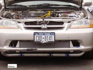

The other thing is the downpipe which connect to the intercooler. The easiest way is the one shown here Name:  intercooler.jpg
See how low the downpipe hangs? By going over a speedbump or potholes, you're just asking for trouble. Of course there's always around to everything. A custom fab downpipe, but that will cost alot.
And there is a solution to the tranny also, which is to swap in a manual.

i would also like to note, thats not a down pipe..... thats the charge piping/innercooler piping...... the downpipe is what comes off the turbo exaust connecting it to the cat (assuming you have one)
