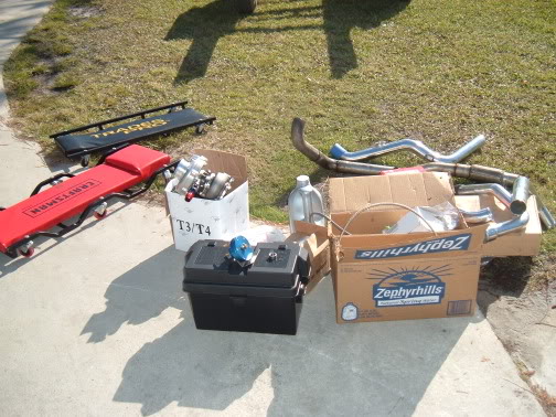

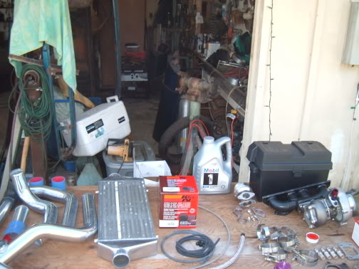

Here's the stuff set out before the install.

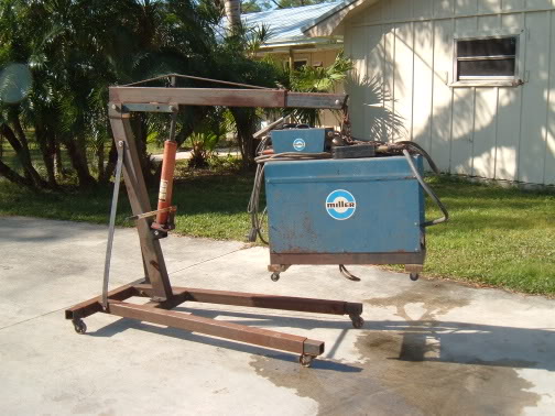

The welder seen here helped the project tremendously.

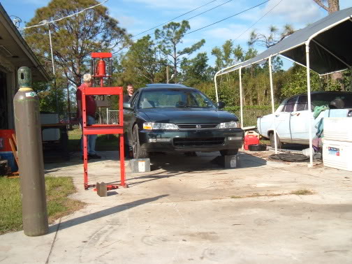

Here's the car on the drive-ups awaiting the install

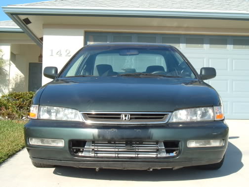

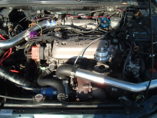

This is after the install of course.
Another angle of the new and improved engine bay.

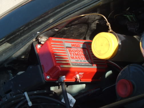

Here's a close up of the MSD Boost Timing Master and my new windshield washer fluid container (had to rip out the old one to make room for the charge piping).

No problem. Here's a list. Sorry if i don't have specific part numbers (ebay doesn't go back that far). If i forget anything, feel free to call it out. All stuff off ebay unless otherwise noted.
T3/T4 Garrett Wheel Hybrid .63 (new in box off ebay for 256 bucks)
F22B Log style manifold from f22parts.com (was warped when I bought it. May want to look somewhere else before dropping the 300-400 bucks on it).
HKS 38mm external wastegate
Raptor style BOV
Prelude intake pipe kit with BOV flange welded in. (I haven't seen this on ebay recently, but it bolted right up. Just had to get rid of washer fluid tank). Came with all hardware!
Vortech 12:1 FMU
Walbro 255 Intank fuel pump
Godspeed front mount intercooler
MSD Boost Timing Master (jegs.com)
Steel oil line and fittings
Oil drain kit
K&N Air Filter (Advance Auto)
Vacuum line, bolts, clamps, etc (Advance Auto)
Autometer boost guage and air/fuel ratio gauge
Downpipe was used from someone with one for a 97 accord ex. I had to cut off the flange and re-weld it at a different angle. Also had to add o2 bungs. I recommend either getting one from a kit (like drag), or finding a used one like i did and modding it for your use. Otherwise, take it to an exhaust shop. You can even piece together a mock downpipe in PVC and take it to the shop to actually fabricate.
I would also recommend some injectors. I think that's my next purchase...
I'll try to shoot some video thursday if everyone is still interested. Thanks for the hosting offer sir nasty.
