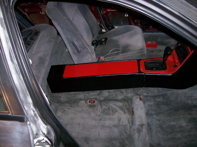

I painted this entire console with Krylon fusion, plastic pieces, bondo, mdf, everything. Still looks like that too.

dude that looks nice! so how would i go about prepping the plastic pieces? and you said it would cost more if i didnt remove the vinyl myself. how do i remove the vinyl? and do you know about how much it would cost to get the dash re-vinyled? again, thanks so much, this is a huge help!!!
Your paint job looks really good...Nice job!
