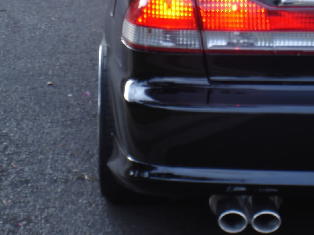

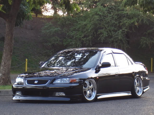

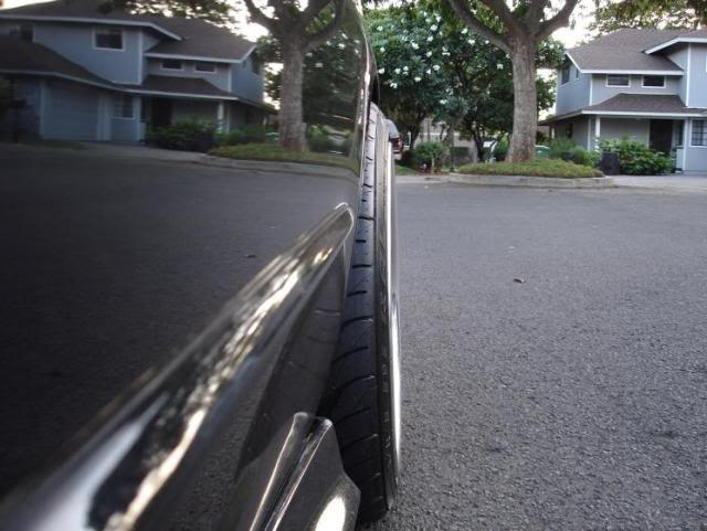

An offset of +35mm is WAY too low for an Accord. My 99 has +45 18" wheels on, perfectly flush with the fender.
This is +38mm on a 01-02 Accord with 18x9 wheels:

Yes, drop the car on a $4,000 air bag system and run extensive negative camber so they don't rub.
It might look goofy, but they will fit and have the correctly sized tires. If you're lowered, they are almost guaranteed to rub on bumps. If you're not lowered, you should be fine. Also, stretching tires can be another way of getting them to fit, but most people don't like that look. (The pictures above are with stretched tires)
Are the wheels being sold locally? You can always test fit them before you buy.
