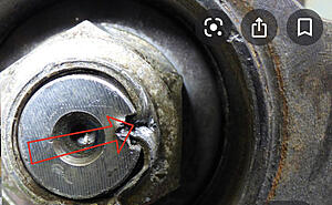

I have an 04 accord,2.4,stick. I have been trying for days to get the axel nuts off, I have broke ratchets, breaker bars, I have tried to put torch on them, I have even bought a new 750ft lb air impact. Still can’t get them off. The car had brand new axels put in just before I bought it, the mechanic that did the install said he used a torque wrench and torqued to spec. I guess I will have to cut the nuts off and hopefully don’t damage the axels!

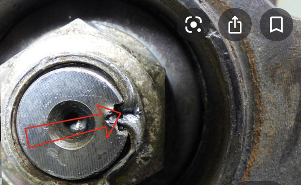

Did you unstake the nut before trying to unscrew it. They are not hard to get off. I use my Dewalt battery powered impact for all the ones I take off.

Yes I unstaked it. I was even considering cutting all around the nut on that lip just to eliminate that possibility

You may be subject to someone putting red loc tite on the threads. What I would do is take a 3/4 breaker bar, 3in extension and a long pole (I usually use the one of my jack), with the car on the ground, withwheel on try to break the nut (maybe heat it up first).
I have had to take a wheel saw to one that had red loc tite on it but I didn't mind changing the axle either.
