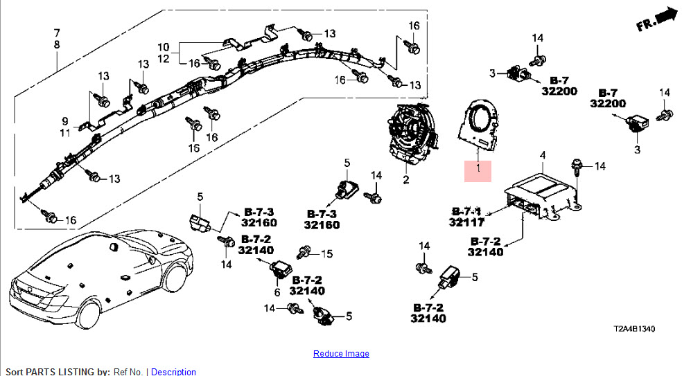

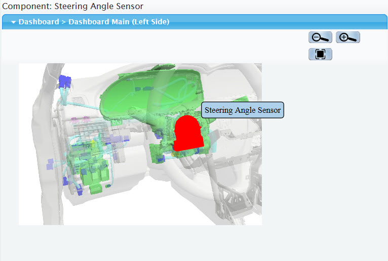

Advance Auto may or may not have a reader/scanner capable of reading Honda ABS/TCS trouble codes.
Although the steering angle sensor can cause VSA (Vehicle Stability Assist)* issues and trouble codes, just changing the ride height would not generally affect the steering angle sensor. The steering angle sensor is part of the steering column. It is used to confirm the steering wheel position. The steering angle sensor for a 2013 Accord is shown in the attached images.
*Vehicle Stability Assist (VSA) combines Anti-lock Brake System (ABS) and Traction Control System (TCS) with sideslip control.
Attached Thumbnails Dash lights on after tein spring install-steering-angle-sensor.jpg   Dash lights on after tein spring install-steering-angle-sensor-part-diagram.jpg
