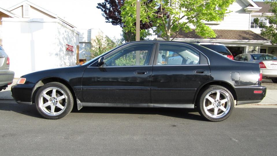

Okay, your ride height looks perfect to me ... looks like 1.2 springs are a safe way to go. I can pick up a set of Eibachs at PartsGeek for $212 ...
btw, what shocks are you using? I know this should be covered in other threads, but I figure I should ask since you have the spring height I am looking for.
Also, do you have a direct side shot of the car? A shot of my car is attached. Yes, it looks like it could use a full inch or so.
Thanks. John

I am on stock struts, which isnt really recommend, but I have had it like this for 6 years and the struts are still good, granted in the past 3 years I have put about 150 miles on the car.

I am too busy hatin on your car.. that thing just looks beautiful man.. that's like the ideal look, subtle and beastly..
Old May 5, 2012 | 07:12 AM
Thank you, the car isn't where I want it yet. Hopefully within the next year or two it will be.
