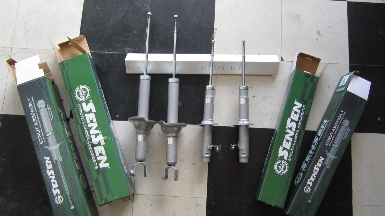

Not wanted to have a car sitting in my driveway for a month with no suspension, I looked around for a set of cheaper shocks, found a lot of positive reviews on the performance of Sensen (mixed reviews on reliability, but positive on performance), so I decided to grab a set and use those as the temp replacements while the Koni's are off being repaired.
The Sensen cost me a whopping $93 for all four from RockAuto with the 5% discount, no tax or shipping ... hard to beat! That's compared with the great price I got for the STR.T ... $300 for the set.

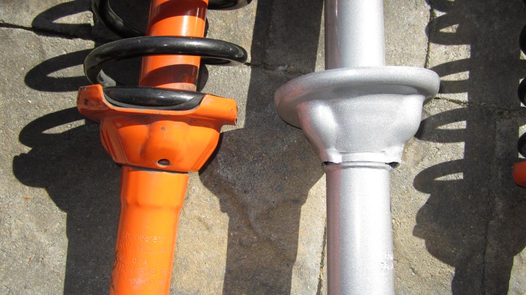

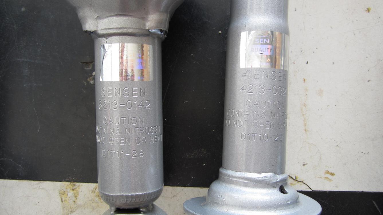

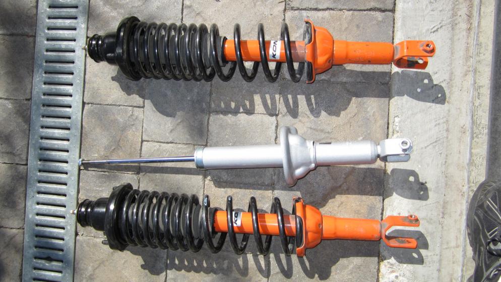

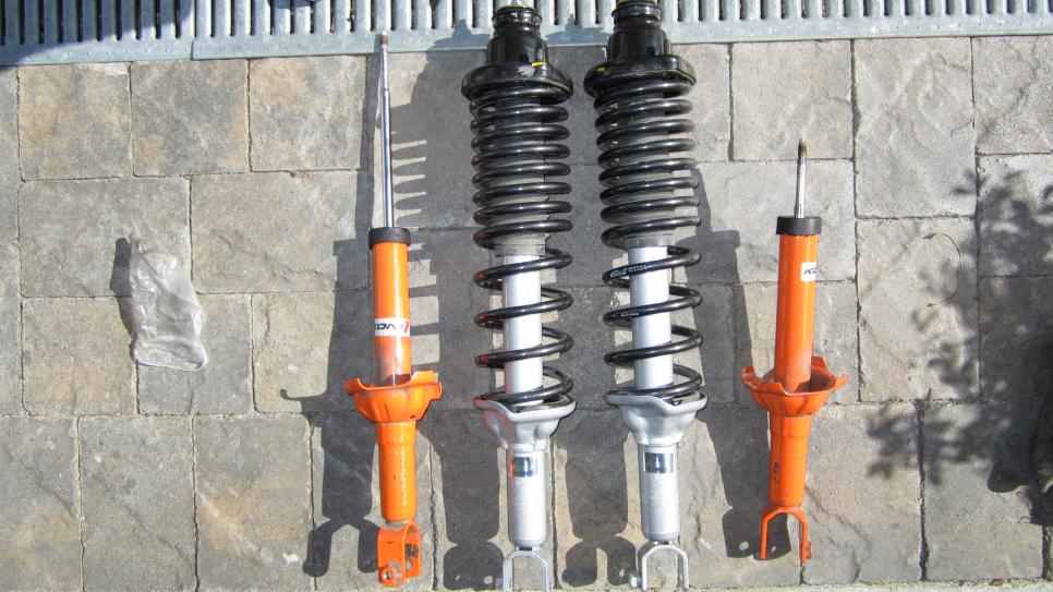

* Construction quality on the Koni is better ... you can see from the photos.
