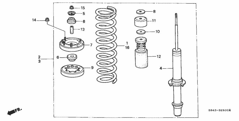

The first picture is the stuff at the top of the front shocks. Do you see the part that's loose or broken?
There are bushings between the subframes & the body. Maybe they are dealer-only parts?
Look at the 2nd picture. There's a large cross-beam (#1) at the lower control arms. There's also another cross-beam (#9) closer to the radiator. I think those 2 are bolted to each other without bushings, but the bushings are between each of them to the car body.

For the strut, looks like #11. I should've taken a picture
I'll go to the dealer tomorrow and ask about those bushings.

Can someone help me with this? Why is it that items 6-8 are not available for a 4cyl AT accord (98) though the schematic is for an accord?
Items 50231-S87-A00, 50232-S87-A00 and 50232-SL4-000
