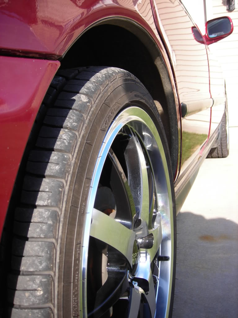

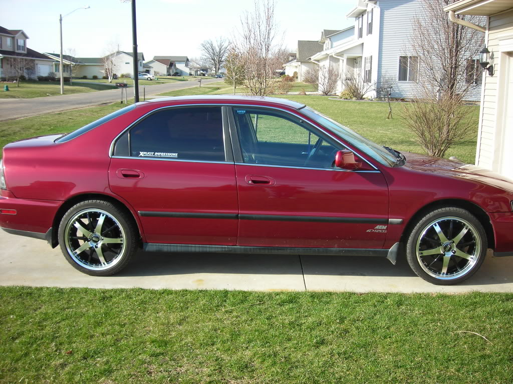

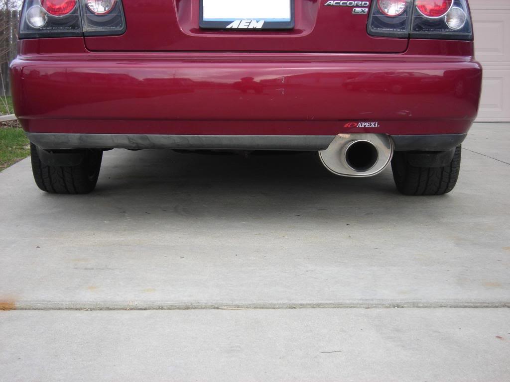

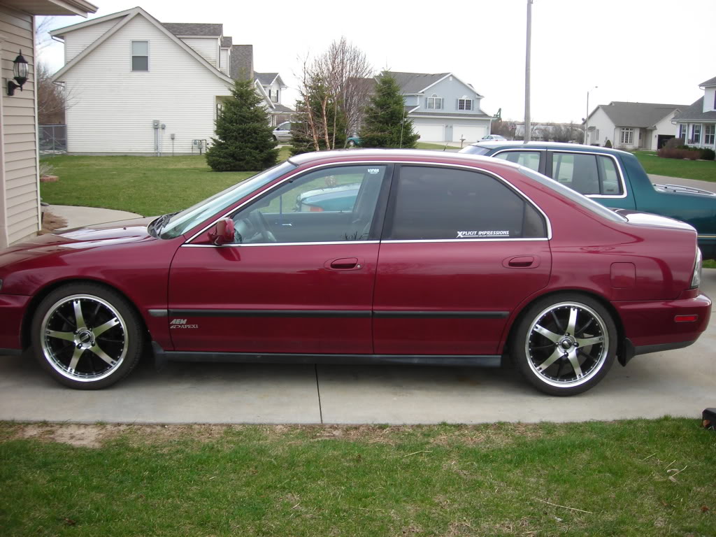

Got it done w/ the great help of some local guys.
I love the way it looks minus the camber, so I will have to raise it up a bit. I am not driving it until I get an alignment Tuesday. It kept making some off popping/hitting noise when I drove over the bumps in the passenger rear.
Here are the before + afters.

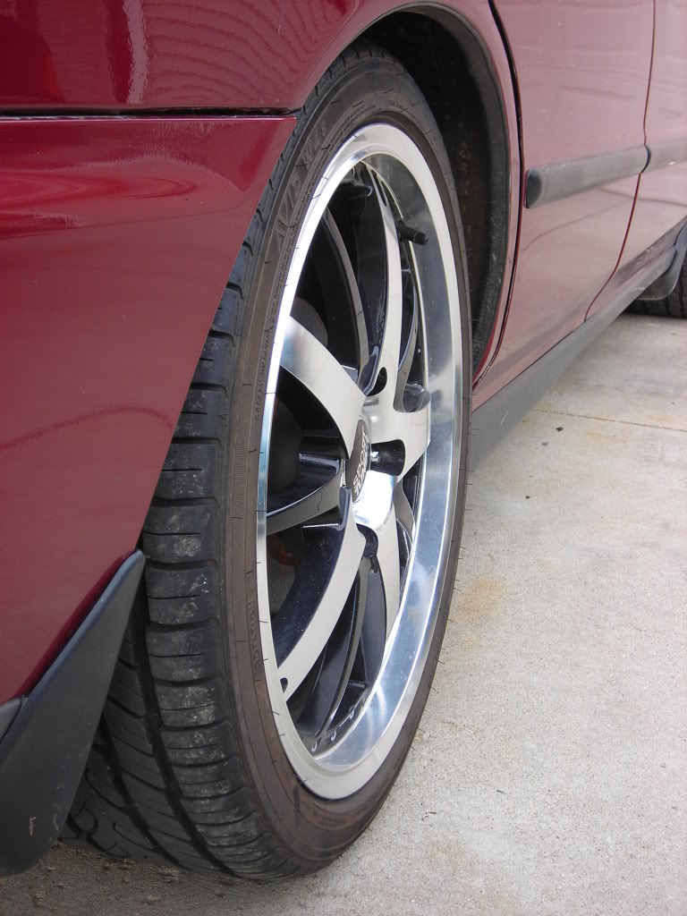

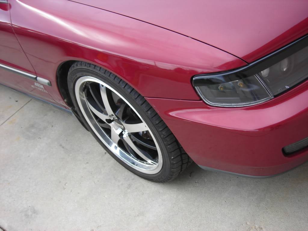

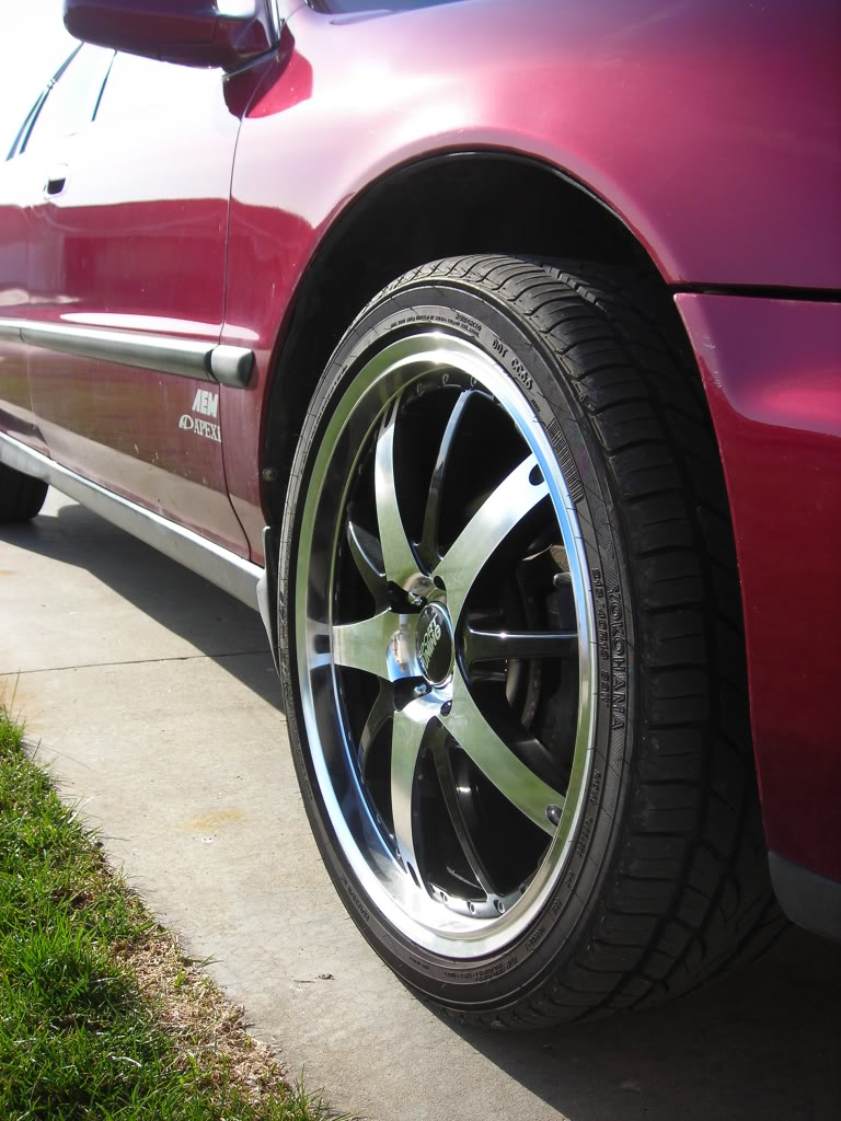

aFTER
terrible camber!
You can drive it before you get the alignment, I drove mine for 2 weeks prior to settle the spring, you should drive it a bit before your alignment too, even though they're used, they need to settle again because the spring has been uncompressed for a while
Why raise it to fix the camber? That will go away with the alignment, both front and rear.

My tires would be destroyed. After I drove home the 11 miles my outside rear part of tire was cold and the inside was pretty freaking warm. /--\ = my camber.
I am raising it for driveability. I know I will get hung up on my speed bumps @ my college. They are tall but are only about 1.5 feet from the beginning of the base of it to the other side so my wheel will be over the speed bump before my rear wheel touches it.

Would not, there are plenty of people running -3º of camber, you're at about -1.5-2º. Tuesday isn't that far away either.

Raised the front like 3 threads and didn't do anything. lol I couldn't adjust the rear b/c the car tires are still on the ground when my jack is maxed out. Hmmm.....
I have the front struts @ the 1 setting out of 4 and the rear is on 1 out of 8.

You really need to find the height you like and drive around for a while, I swear on my mother's grave you will not eat through 600 treadwear tires driving it for a week. Then, get the alignment, see if they can get the fronts in spec at the height you want, and if they need the front camber kit, bring it with so they can install it. Don't just throw something in if it's not needed, which I will tell you again, it's not needed. You will add clunks in the front to accompany your clunks in the rear.

Found out what the clunk was, the top of the strut pole is hitting the metal bracket behind my seat when I hit bumps. I am going to loosen the nut so it decompresses a bit and lowers the strut bar to the same height as the other side.
