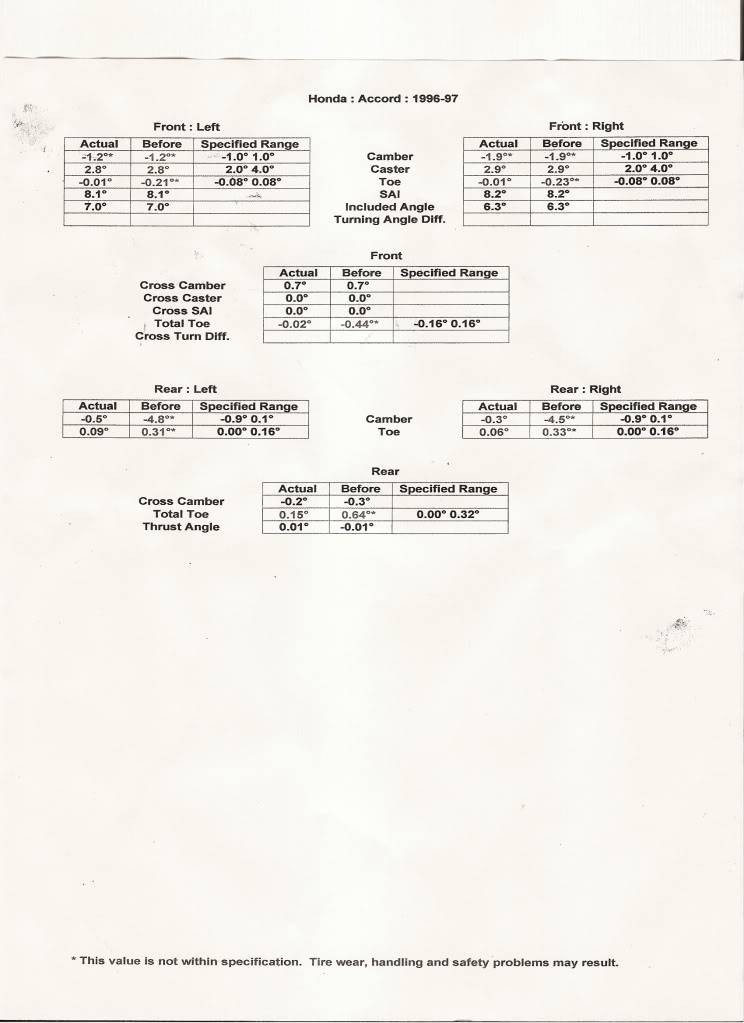

Do these people know what the factory camber spec is? It's like -0.5*, so -1* is not that horrible.

So I am positive the strut is blown. I smelled the brake fluid compared to the fluid on the ground and it is not the same. I also put the front struts on the 4 setting (max stiffness) and the pass. wouldn't bounce where as the drivers side would.
I still am lost for the rear strut hitting the backseat metal support bracket. The guy said that may be a bad strut too.
They didnt want to press out/in my balljoints/camber kit b/c they were afraid of bending the control arm. He said they could try it....lmao So I am going to get some anchor bolt style and he said it would be $20 to install them. Anyone know where I can get a decent set?
Here are my camber readings (look @ the rear before!!!!) :
