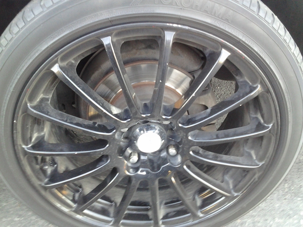

I have 93 Accord coupe ex. I noticed a bad vibration when speeding up. got tired balanced, tie rod replaced. still I know i needs rotors, but the vibration happens when speeding up and a high speeds. I don't think rotors cause that. The vibration in more on drivers side. my door panel shakes.
Oh and my passenger side front tire looks flat and my drivers side tirr looks great. Same psi, even with my stock rims.

If the vibration happens when speeding up (accelarating) and at high speed I highly doubt it would be a motor mount issue. Worn or "warped" rotors (99% of rotors driven on the street don't warp) wouldn't cause this issue either. My bet would be the tires. Looks like you're running the same size wheels and tires front and rear. I would rotate the tires and see if the vibration goes to a different area or goes away. Tread separation, a flat spot, an out of round tire, etc can all cause the sympton you're describing.

I have rotated, balanced, and put on my stock rims and tires on it still happens. I shoul add that its mostly felt on the drivers side. and i would think the probems on my passenger side sense I had that axle replaced. about 7 months ago. but i will try moving them around lik3you said to see if it works. thinks and ill get back to you with the results. thanks

Well if you put the another set of rims and tires and you still have the problem then likely it's not the tire(s). Have you checked your wheel bearings or cv joints?

I took it to the shop and was told it could be my tires. I was shown a high speed balancing of my front tires showed they would go out of balance after being balance. I was also told to CV joints was perfect, but might have some concerns regarding a slightly bent wheel I had. I will try to move them around you to see if anything changes I'm going to try once more with my stock rims and move those tires around. I will post my final diagnostics and see if that's the problem
