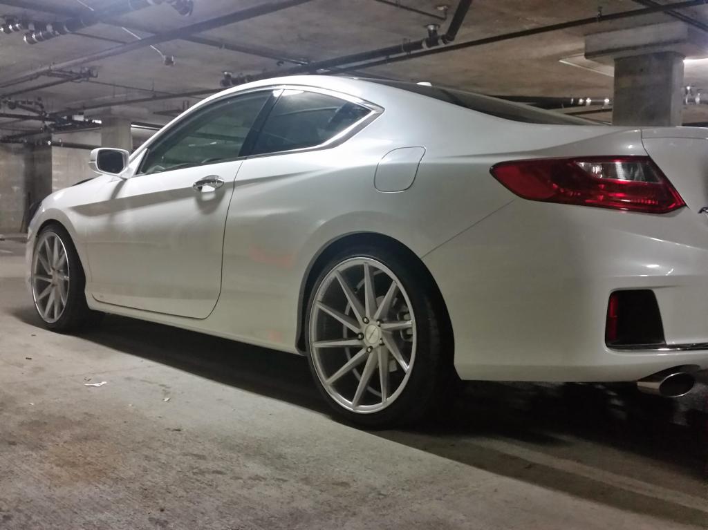

Coupes are super cool, nice choice! I bought a new coupe EX drove it for 20 years till last month, so guess what I went out and bought a 2014 coupe. Bought and sold so many cars over the years but always kept the coupe. anyways back to your question, I put on 20x9 fronts and 20x10.5 rears. Vossen CVT's with 45 mil offset and lowered it 1' front and 2." rear with H&R springs. I get two fingers gap between tire and fender front and back. Havent rubbed one out so far. But if I do its gonna shred some tire for sure and if its a big enough hit fender will meet rim. my best guess is that the rim sits 2-3 mils outside the wheelwell. Im gonna roll the fenders something I was hoping not to do. But even then that only saves the rubber not the rim. Heres a pic. Cheers
[IMG][/IMG]

Nice setup! Is the +45 offset for the front and the rear? Thanks in advance!
