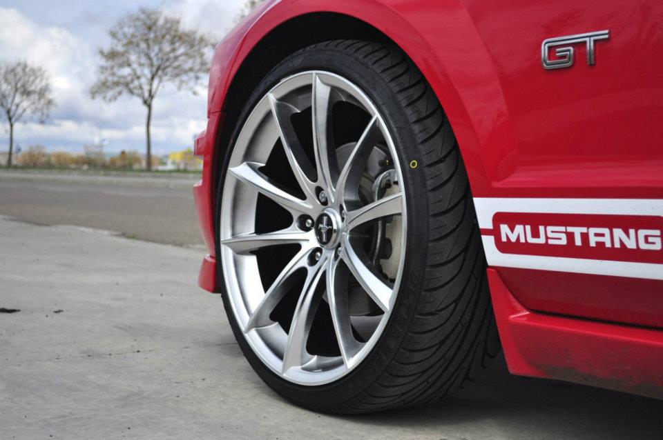

Here is my information on this fit up...
On your car, the recommended size to go with is going to be 215/40/17"...even if you were going to an 18" tire and wheel combo...I would only be selling you a 215/40/18" pkg for your car..and that is for a 1990 thru 1997 Accord..
Attached Thumbnails 97 Accord- Finding the right rims-580199_10151466074965618_298621765617_23125251_152873002_n.jpg
