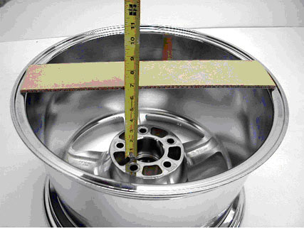

The bolt patterns are the same 5 lug X 114.3mm and the hub size the same 64.1 mm the off sets are the same High+40-55 mm and the thread size the ame 12mm X 1.5mm...so you should be okay..always test fit the 1st for clearance before you buy them..that's a rule of thumb.
