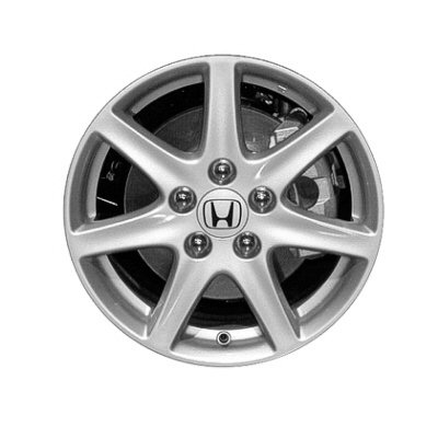

Looking for new rims from junkyard but dont know which vehicles are compitable with my 04 sedan Accord. If anyone can give that information, it would be appreciated.

USA??? I'll assume that, but you didn't say.
2003 to 2006 Accord would be direct fit.
Wheels from 1998-2002 V-6 Accords will bolt up. (The 4-cyl cars have 4-bolt wheels.)
Newer than 2006 Accord will still bolt up, but I suspect that some versions have wider rims than yours. Probably still OK, but I'm not completely sure if any of them rub against your shocks.
2006 and newer Civic wheels will bolt up, but they are generally narrower than the Accord wheels. Exception MIGHT be the Civic Si with 17" wheels.

Thank You Jim for that good info..That should help him on his quest for those new wheels..or Used wheels..
Click on the images to make bigger wheels
