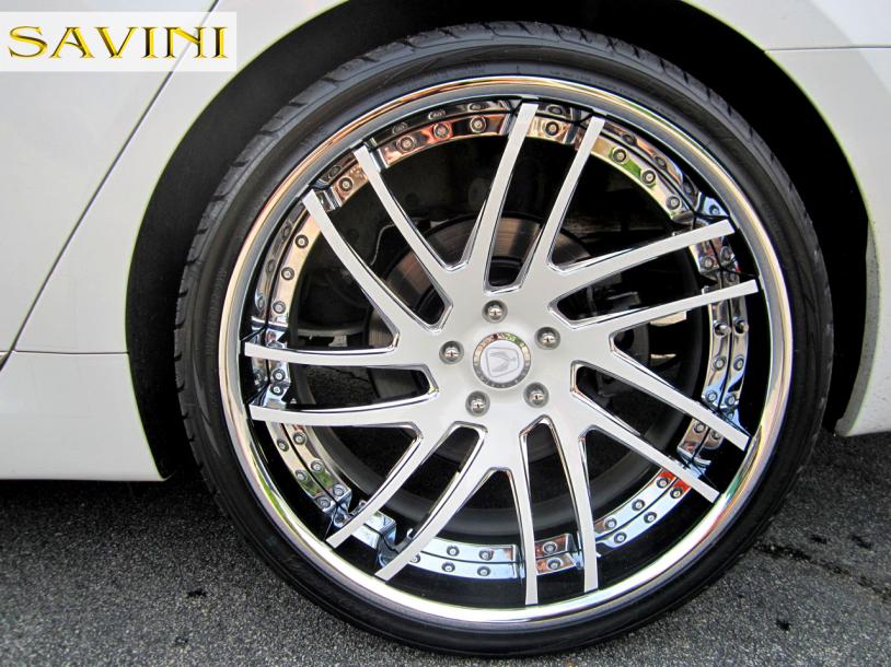

I agree with Shippo 200% . 18"s cost less and fit much better than 20" wheels..
Attached Thumbnails Which size 18 or 20??-4b2f4563-3e43-48e8-9590-3c09182fb6f1.jpg
