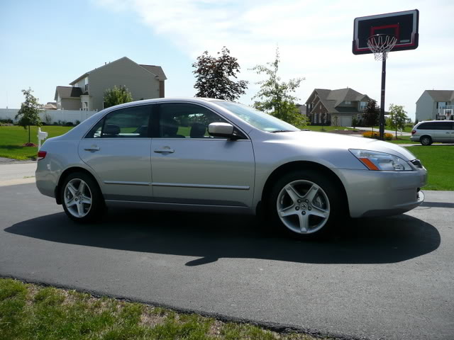

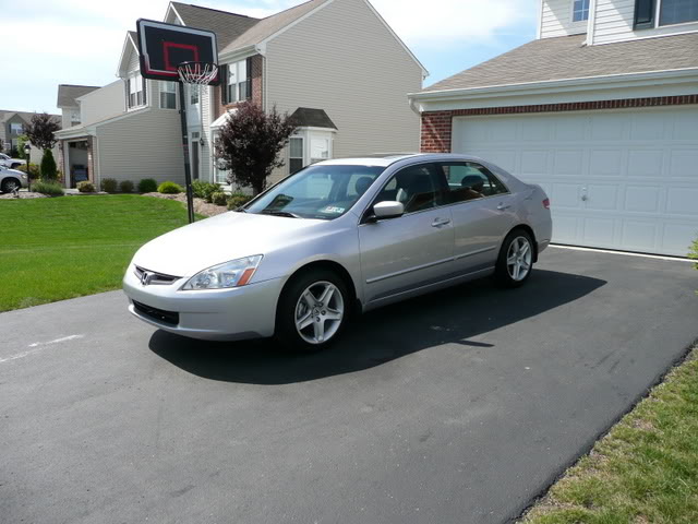

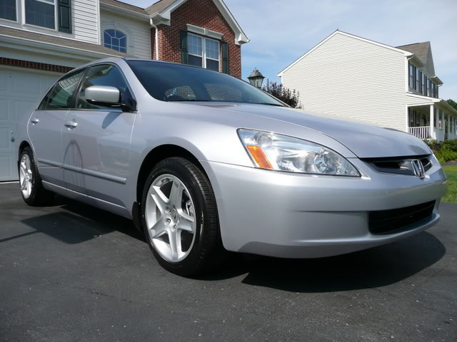

So here are the pics: Like I said before 2003 EX-L with the 06 TL wheels.
235/45/17 Michelin Pilots
I like how it turned out...
