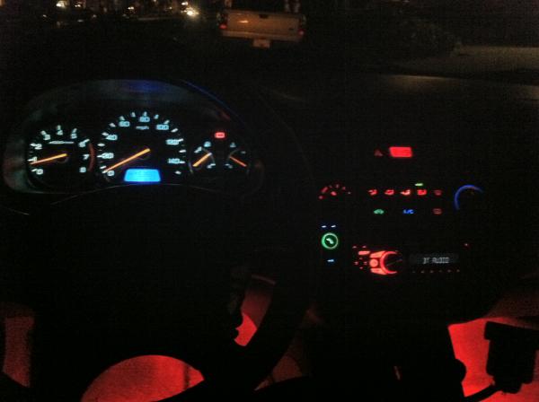

Originally Posted by iMarkDD
This is my girl after full light conversion. White gauges, blue odometer, mostly red down the center but with custom color filters on a couple of the buttons.
Nice setup. How did you add power for the foot lighting? Did you get just a regular led strip off from ebay? Also, what are the custom filters made out of?
